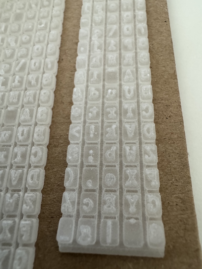

I bought a printhead on eBay last year at this seller: https://www.ebay.de/usr/tectcm
Obviously he had some mats printed and sold it on eBay for 25 €. Seemed to be a one-time-shot, since he does not offer it at the moment.
As far as I could find out, the printing supplier was
http://www.rapidobject.com
3D-printing technique: "Polyjet"
Material: "Silicone GH1 Shore 65A"

I don't want to discourage you, but with FDM printers (hot filament squeezed out of a nozzle) you will not have much fun in producing those.
The resolution is too low to have a meaningful result.
The "Polyjet" principle of Rapidobject is comparable to a 3D-inkjet print and delivers more precision and resolution.
